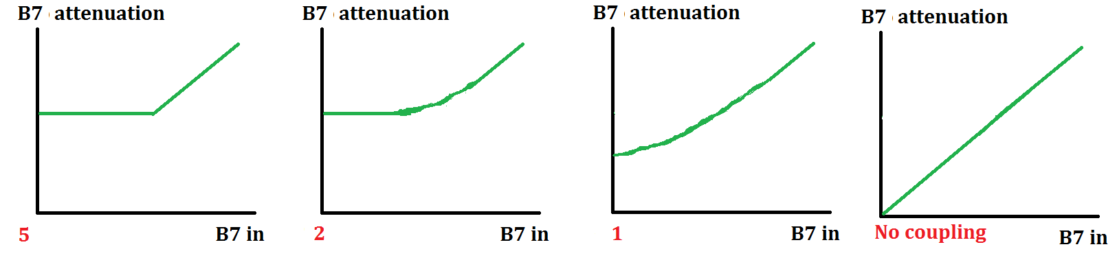

I think the following image shows the effect of the 3 different coupling methods on the attenuation of band 7 at different band 7 input levels
PostPosted: Fri Dec 26, 2014 10:59 pm
Posts: 167
The leftest picture´s behavior is IMHO the best. But why has it to be in dB?
This behavior but with percentual coupling value would be perfect. So the effect gets smaller if th relative difference between bands is bigger.
That´s what I´ve tried to tell you...
PostPosted: Fri Dec 26, 2014 11:10 pm
Posts: 167
It's what I'm using now! But this is the furthest away from what I think you asked, which is method 3 (linking would stop a band from going up more than a number of dB's above the level of the source band)
linking would stop a band from going up more than a *percantage amount* above the level of the source band.
That´s what I meant.

PostPosted: Fri Dec 26, 2014 11:25 pm
You're saying two different things in your 2 posts above:
You're talking above relative difference here.
So:
With 50% Linking, Band 6 has 12dB Audio:
Band 7 will not go above -6dB
Band 6 has 6dB Audio:
Band 7 will not go above -3dB
But this is not relative but based on absolute attenuation levels.
I don't like absolute levels because - see my description of the S tones above - it would behave completely different in the different scenario's, leading to big differences in sound depending on the MB input level.
Now, if I use relative difference levels as you wrote in your first reply, because the relative difference changes when the level of the band the we're linking to changes, there cannot be an angle as in image 1 (method 5), but it has to be gradual such as in image 2 or 3 (methods 2 and 1).
PostPosted: Fri Dec 26, 2014 11:52 pm
Posts: 167
For me, a linking defined in dB would mean this:
With 6dB Linking, Band 6 has 12dB Audio:
Band 7 will go to 0dB.
But that´s not good.
So I mean to define in percent, relative to the source band´s gain reduction.
I don't understand why in this case couldn't be such an angle like in the Method 5 picture. In this picture I assume a constant level of band 6, only band 7`s Level changes.
And when Band 6 stays at -12 (cause of the audio in it), then a linking value of 50% would be the same as 6dB - until Band 6`s gain reduction changes. If band 6 goes down to -6, the 50% linking value would be the same as 3dB.
And when the Level for this example stays constant, and only band 7 gets more audio from total silence in it until a high amount.
