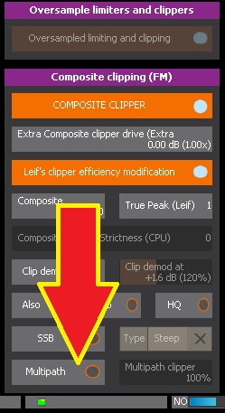

Posts: 85
Hi:
This bug persists
Problem with multipath configuration.
When activating the Multipath option and closing StereoTool, once it is reopened, the option always appears disabled.
ST 9.92 B48 - Standalone - 64bit - Windows 10 Home
Best regards from Chile
