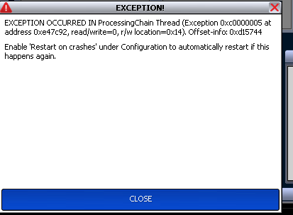

I get this error when starting the last beta!
PostPosted: Thu Aug 25, 2016 11:25 am
Posts: 326
Hans, excuse me, was my mistake. I had to reboot and installed win 10 updates, thats why i had gaps...
I noticed after i installed up to 15 beta versions back..!
Anyway, Beta 25 is ok, dont remove the clock.
Soz for the mess up.
PostPosted: Thu Aug 25, 2016 4:18 pm
Posts: 11460
Fixed:
- Previous version could crash on startup. Should be solved now.
