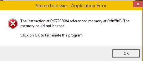

Every time I adjust the number of bands in MB2 i get an error. Sometimes ST Gui just freezes , sometimes windows will terminate the software and sometimes it shows the attached error code.
I think I found it, this is a compiler optimization that's too aggressive; it assumes something about the data that wasn't true. If it's that, it's fixed now (next beta).
O and btw, these errors have a 50% chance of occurring (depending on OS version etc.), and if it does it doesn't necessarily have to crash (it can also cause bad audio).
Hans the latest beta still has the same problem. Thanks.
New bugs found. When i click on the new single band compressor meter the gui freezes and the limiter meter in the new single band does not go less than -12db.
The only bug that i am not able to replicate is the bug regarding the windows resize.
