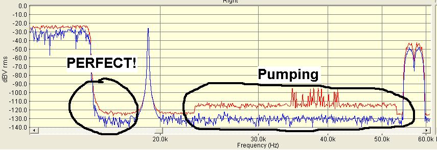

PostPosted: Tue Jul 28, 2015 7:46 am
Let me begin :)
Beta 18 - L+R slope issue is now FIXED , horray !
Ignore frequencies above spike is FIXED !
But at some certain frequencis , jumping noise floor is there . I see it`s presented on 18505 ( may be from 17650 to 18800 jumping is there ) . Exactly at 16000 there is jumping , but if i move above 16130, this jumping is gone . Looks like at some points there is a problem.
But this time many things are fixed . Slope of L+R is again the Perfect , please don`t mess it anymore :)
The other little issue remains is L-R pumps that appear if i feed with signal (for easy find , the signal is white noise) , but i`m sure it make it the same with music but the music must be mono. That`s why the easy way is white noise with 0 degrees phase difference between L and R.
So Hans, there is a big progress . Keep it up !
Look at the picture - see what is Fixed ( labeled with PERFECT!) and what is the pumping . It`s not presented without AC on ( not big deal but i know you can find it and fix it. :)
