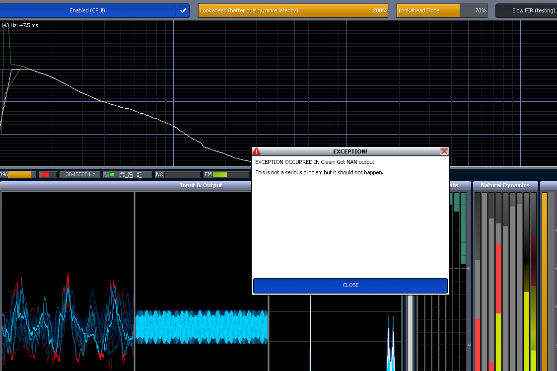

PostPosted: Wed Dec 24, 2014 3:25 pm
Posts: 140
Finnally found some time for testing..error with phase shaping:
