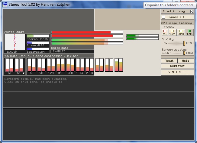

I'm getting occasional graphics glitches with beta20 that I didn't get with beta15.
Please see attached:
PostPosted: Fri Oct 01, 2010 1:52 am
Joined: Thu Oct 15, 2009 12:17 am
Posts: 17
I am getting the same graphics anomalies as superH. Haven't had enough time to evaluate the sound yet.
edit:The missing controls come back if you hover the mouse pointer over them. They seem to disappear if you open any other controls or presets.
