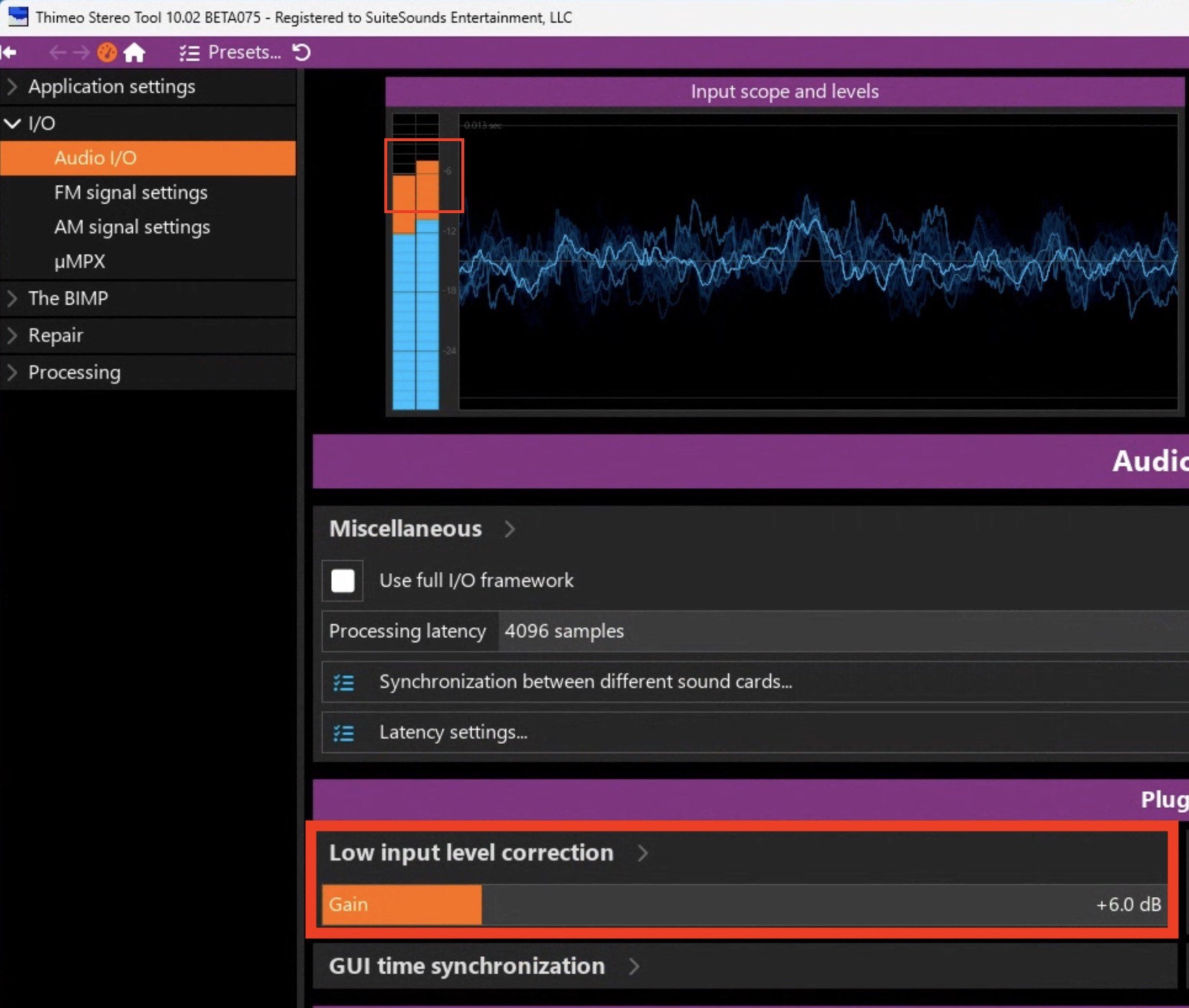

I normally use the input adjustment in ST to bring the average to around -6db on the input meter

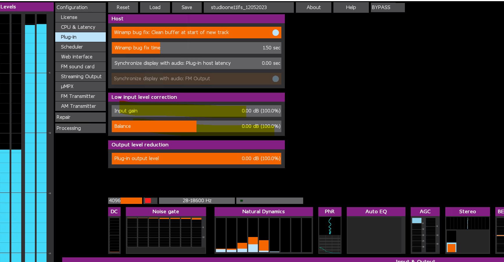

Thanks. Where can I find this option? And what do I have to do then?
Do you mean this section?
Under I/O:

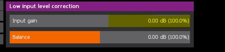

Yes, I am using the DSP-version for RadioBoss.
Do you mean this under "Plug-in"? And if I set this to +6dB I still get -11 LUFS on air (with the -23 LUFS normalized tracks) - or do I have to normalize the tracks in RadioBoss with another number?
Thanks.

Posts: 242
Thanks.
No, -23 for tracks is fine. Just keep adjusting that input gain until your audio is averaging around -6b in the input.. Bojcha's preset will do it's thing and keep it at -11 lufs... Increasing the input gain is what will keep the audio into the preset at it's sweet-spot. You'll avoid AGC error messages and things like that.
