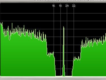

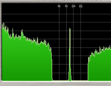

Hans,
Capture of MPX directly from Stereotool...
Capture of MPX from MicroMPX output...
Along with the weird audio rolloff at around 10k to 16k, I also see spikes around both sides the pilot with it occasionally modulating it to around 0.3%
Just wanted to make sure this is normal behavior of MicroMPX or not?
Thanks
Rossco

The weird rolloff is normal, the spikes are not though. What do they look like exactly?

No, that's not how it works. µMPX is not a lossless codec. The rolloff is a side effect caused by the compression algorithm (which does not introduce MP3-like artefacts, but only white noise which is masked by FM anyway). The codec will never remove highs.
