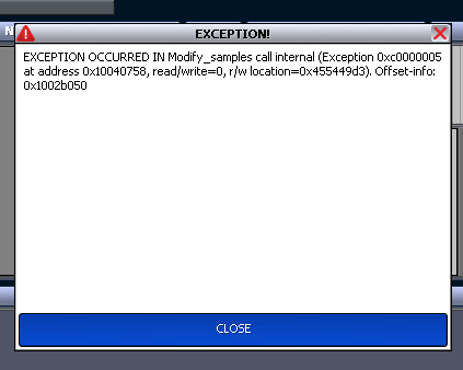

The Winamp DSP version of beta 37 is crashing here when I want to go to the 'Level' tab of the first multiband compressor. Not sure if this was already present in the last few beta's but I didn't notice until now.

Hans - sill seeing Exception error in 37A.
Ugh. Oops. Sorry... I see that I did build 037A, but (because I built it manually because I only needed one new file, not all of them) I didn't run my automatic build tool, which also copies it to another directory from where the installer takes its files. So... 037A was identical to 037. :oops:
So, could you try the same with 037B?
http://www.stereotool.com/download/dsp_ ... 5-037B.exe

Hans - 037B - same...
Rossco
Ok. This time I've been able to find the line of code where it happens. Unfortunately it makes very little sense, which probably means that something in a completely different place in the code is causing something to go wrong. And... I've just replaced about 1000 things in the code in the last few beta's, so that's not very helpful.
So... I'm rolling back the changes that I think are causing this. Will post a new version here in a few minutes, I hope that this version will work again. If not, please send me your settings, it might be that I can reproduce it here if I run exactly the same settings that you are using.

Ok... Rolled back the suspected changes. Does it work now?
http://www.stereotool.com/download/dsp_ ... 5-037C.exe
Hi Hans. Yes! Happy to report BETA037C is indeed working...

Yup... but I did turn of a few hundred optimizations to make it work again. Anyway, I expect that I'll get my new Raspberry Pi 3 tomorrow, I will test how much effect this change has - if it has no effect I will just drop it, otherwise I do need to figure out somehow what's going wrong.

It fixed my problem as well. No more crashes when I go to the Level tab of MB 1.
I get the same problem also in the Standalone-Version. But only when first Multiband ist in Digital-Mode.
