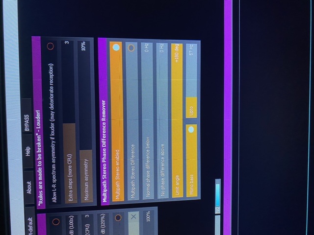

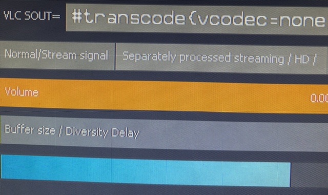

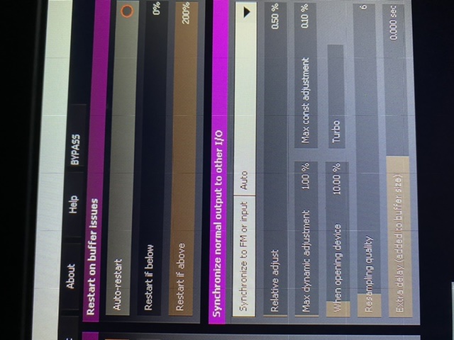

Some short questions about your preset using for Streaming only (no FM). :) to make it easy I upload a few imagies:) All is about the best audio quality for a not so experienced user like me:)
1.
I found this setting: Clipping (in the FM transmittter) active. Shall this be ON or shall I turn it of
For stream only! I hear it affekt my sound when I switched beteende om/off.
2.
Is this the right option for best output of your preset for stream only)?
3.
Does this setting do something with your present (stream only)?
4.
Is speech detection something to activate or not? Have not found so much info about this setting:)
5.
Limiting&clipping option ”Prepair for lossy compression”. Otimize option is off but per-emphasized is on. I shall not turn the 1st option ON?:)
And the last thing: the Repair tools dequantizer, Delossifer and dehummer is off.with a full register license shall I use them in your opinion? Something important to think about then?
Very much thanks for your hard work:)

Clipping need to be ON so Limiter can work.
Every settings is on place for streaming. There is reason why some settings are not ON (streaming related)
Preset does not use speech detection since i don't know how and what it's doing. I check it once and i didnt saw single one reason to use it.
For final loudness level you are free to set is as whatever you like. Best way to do it is to adjust Output level in MB1. Or simply rising or lowering Clipper level.
