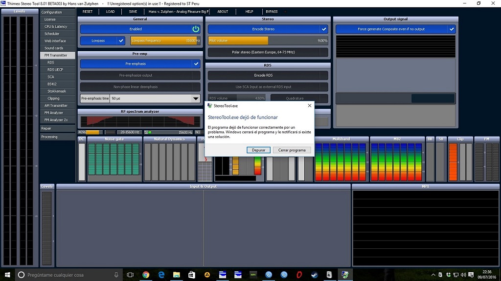

PostPosted: Sun Jul 10, 2016 5:39 am
Joined: Wed Jul 08, 2015 6:55 am
Posts: 6
Error Beta 002 - 003
