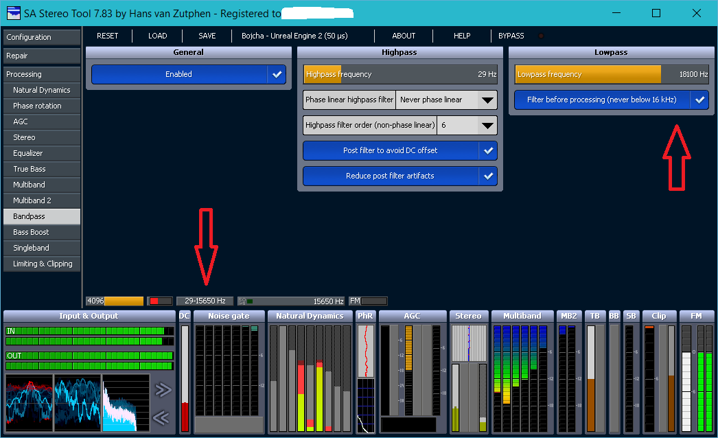

I also use that same preset but I find it odd that it shows slightly different settings for us. See the attached picture.

Up & running solid with 7.83 and Bojcha's Unreal Engine 2 preset.
Sound quality is great and Stereo tool seems very stable.
CPU usage is also OK. Running about 20 stations on a Xeon E3-1245V2 CPU @ 3.4 GHz with some room to spare for OS.
Keep up the good work!
That's because the FM has a different setting in the lowpass filter, if you disable FM transmitter section, you get the 18100 Hz lowpass which is set in the non-FM bandpass.
 Post subject: Re: Stereo Tool 7.83
PostPosted: Fri Dec 04, 2015 6:04 pm
Yes, and if you use both FM and "Separately processed for streaming" Normal output, you'll see both numbers. In this situation, you apparently only generate an FM signal.
