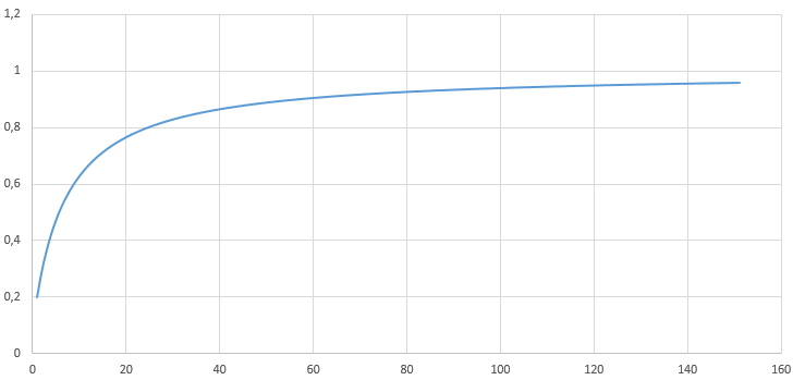

PostPosted: Mon Jan 25, 2016 2:39 pm
Posts: 49
I think it desribes the Notchfilter of the Carrier and affects also the audio.
This is the curve from 0 to 15 kHz.
I hope I can do my tests next days, was very busy on the weekend. We should see it by doing a sweep that when the carrier is not reduced to that formula, that the audio isn't linear anymore but over attenuated in the bass. A bit like RIAA on vinyl....
In the Receiver the Carrier is amplified again by 14dB, so it will be linear again.
PostPosted: Mon Jan 25, 2016 3:46 pm
Posts: 11481
Yes. So please try that, and also if it sounds "kinda" ok. If so I can try to add this function. When I figure out how to interpret it (those shapes look a lot like what I had expected, where did you find them?)
PostPosted: Mon Jan 25, 2016 4:33 pm
Posts: 49
I made an Excelsheet and put values from 0 to 15 in 0,1 kHz Steps into the formula for "f". I don't know what j means, I just ignored it :D
PostPosted: Tue Jan 26, 2016 4:47 pm
Posts: 11481
Btw according to the text, f is in kHz, so the graph would end around 15 or 16! Ugh...
I wanted to continue with this but now I really want to wait for your test results again :)
PostPosted: Tue Jan 26, 2016 5:25 pm
[...] I don't know what j means, I just ignored it :D
j = i = sqrt(-1)
