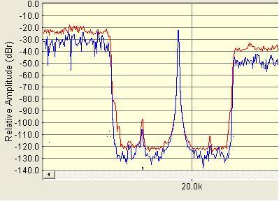

Edit : And some other bug . When you use "Lowpass" in the FM transmitter panel together with "Ignore freqs" (main Bandpass is OFF and must be OFF, so this can be reproduced), there is a spike like before , but this time it`s not exactly on the "end frequency" of "Ignore freqs" option but arround 500Khz above it. It`s moving again when i move the slider of "Ignore". And again it`s getting weak with increase of frequency. Picture is made with slider of 16200.
Spike presented both in 44.1 and 48 Khz sample rates.
