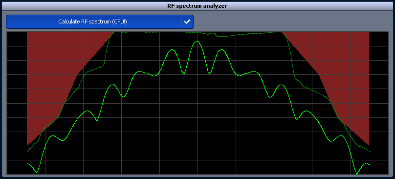

New Stokkemask clipper output with test tones.
For normal audio I do measure some small overshoots, but that's probably ok - the smoothing used in the Stokkemask specification should remove those - in fact, even without the Stokkemask clipper overshoots are pretty rare due to that. I have not implemented this smoothing in my analyzer. Also the analysis filter shape isn't perfect - it seems to be a bit too wide at the top, which may also cause the display of small overshoots that really aren't there.
