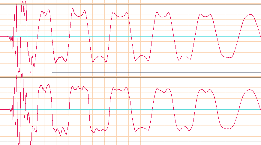

Top: Version 6.30. Bottom: BETA004 with same settings. Track: DBN - Jack is Back; only Loudness used.
The reason why it's not flat but bumpy is that the input signal isn't a perfect sinusoid.
