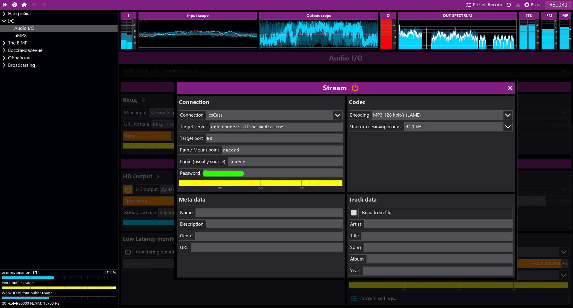

It shows that there is a connection with icast hosting, but nothing is playing on the hosting. The problem with version c 10.41 and all version 10... Earlier versions 9 is fine. What is the problem? :?:
The yellow bar indicates that the streaming library reports back that the stream is working. Do you get any popups about restarts? I assume not... If so, I have no idea. We could try to look into it but for that I would need access to this server.
