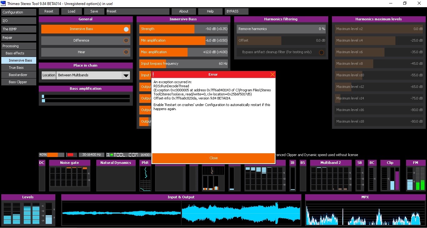

Posts: 85
The following error appears within a few seconds of starting ST.
1.- Version Standalone 64 bit
2.- Windows 10
3.- The interface freezes and there is no more audio.
4.- Impossible to close the program. You have to do it with the Windows Task Manager.
5.- It is solved when closing and reopening ST.
Best regards from Chile
