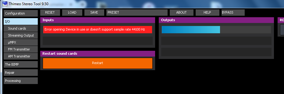

Problem. After installiing Breakaway Pipeline. When ST is open now it is showing
https://i.postimg.cc/mD455RNy/error.png
Odd. I know the Breakaway pipelines support 44.1khz. Is this after you followed the rest of my instructions, such as setting the I/O> Sound cards> Input> then under Input> Input Device ID> choose "Line 1 (Breakaway Pipeline) (Kernal Streaming)" from the drop down menu. Not WASAPI or MME. It might be that last part that I left out.
If you did, Try Selecting I/O> Sound cards> Sample rate> then under General> Sample rate> choose "48 kHz" from the drop down menu.
Otherwise I would suggest rebooting and then seeing if Stereo Tool finally has the Line 1 (Breakaway Pipeline) (Kernal Streaming). Not WASAPI or MME.
PostPosted: Tue Jul 14, 2020 10:04 pm
