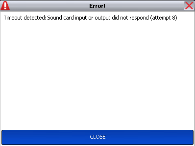

I'm now getting this error just about constantly in the stand alone versions. It doesn't seem to matter which sound card I'm using, which protocol, or whether I'm using my Breakaway Pipeline virtual cable. Tried rebooting, 32/64 bit, changing sample rates, buffer sizes, affinities, priorities, uninstalled VM Banana, etc... and nothing seems to stop it. This is even happening on 9.38 betas, and 9.37.
This just started happening after the latest official release, but not immediately. I would say it was in the last week.
Could it be a Windows issue? Could it still be some issue with Breakaway pipeline, even though it's not being used?
Yes am seeing this too when ST is left operating for a while - say 8+ hours - but I also see more reports of buffer underflows on FM out that is going to the Breakaway pipeline also.
I have another test machine where this does not happen but instead of outputting to the Breakaway device I am outputting to a soundcard.
Running the current version of the BA pipeline, it has been repaired, uninstalled and reinstalled without any change.
Windows 10 64 Bit, ST Standalone v9.40 (I have tried an early v9.38 beta and see the same issue).
Currently running with FM Soundcard turned off to see what happens now.
Am running uMPX anyway and was using BA pipeline to monitor the MPX signal via on-pc apps...
Ross
This happens within the first 5 minutes for me, and continues every couple of minutes.
I should clarify, I'm on Win10-64bit Version 10.0.18363 Build 18363.

If this suddenly started happening and now also affects older versions of Stereo Tool that worked fine before, it can't be a Stereo Tool issue.
I don't know what is happening but I can tell you what the error means. Basically, we open a sound card (for input or output) and tell it to "run". Then that sound card will (in case of input) regularly give us a bit of audio or (output) ask for a piece of audio. This error message is shown when that doesn't happen for multiple seconds. There is no other clear error at that point (the sound card opened without issues).
I have seen this, not just in Stereo Tool but also in other programs, mainly with bad sound card drivers (where opening *should* have failed but didn't for example). But if it's happening with different inputs and outputs that doesn't really make sense. Have there been any Windows updates?
If it happens after running for +/- 8 hours I assume that for some reason the sound card stopped responding as well...

No, I had Windows Updates disabled after I saw a warning that the upcoming windows 19041 (version 2004) messes with virtual audio cables. But I'm definitely still on version 1909.
The only drivers that were updated were video card drivers, which have some sound drivers in them. However I don't use those devices.
Anyway, like you said, this likely isn't a version 9.4x issue. If I can find enough info to start a thread about it, I will.
edit: Okay, it seems to have resolved itself? Whatever was causing it seems to no longer be an issue. Sorry for the false alarm.
