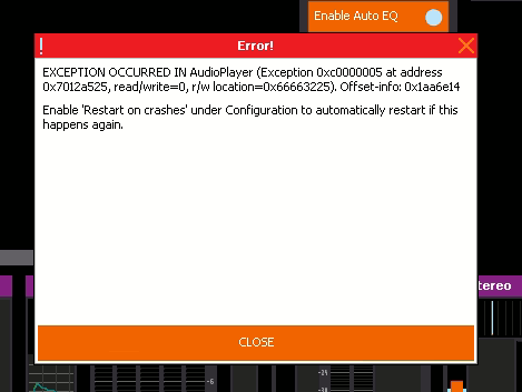

I'm having issue's with an Marian Trace Pro.
When i start ST, i am getting an error that relates to my driver. ( latest version installed )
When i reinstall ST it will work again, until i restart ST...the error returns.
With BBP One it works flawlessly

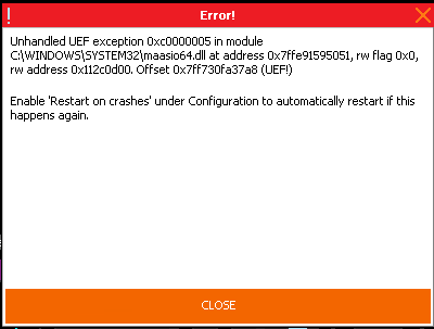

We are running this version for one week now. Unfortunatly we have some issues regarding the streaming output.
When we get this error notification the connection with our icecast server is lost. Processed audio from the normal output continues to work.
When stereotool is restarted, the icecast connection is restored.
Our setup: Windows 7 on an i3-2125 with 8GB ram. A trace Marian alpha card is used for audio.
