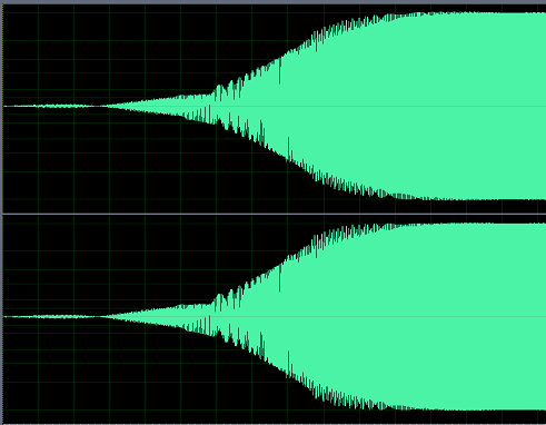

It's clear what is happening with sweep.
Legacy 30Hz and next is New at 39Hz.
https://i.imgur.com/x8Q5vF7.png
PostPosted: Mon May 20, 2019 12:25 am
Posts: 11519
Ah I see it now. As soon as you disable Legacy, that new setting gets enabled as well. That makes sense (since you're changing things manually at that point already).
While this is clearly bad for sweeps, it's better for actual music. If you don't believe me, try this (more extreme) setting:
- HPF at 60 Hz
- Turn that new setting ("Act as if") on and off, and you'll hear far more bass with it on than off.
Note that if for some reason you have a lot of very low frequencies, it might actually be bad - but that shouldn't normally be the case.
Setting Quality to 150% will greatly improve things, by the way.

I know all that. AGC and MB acts like all is filtered.. how it should be.. but artifacts that are present since ever (except at 150Q) are worse and less filtering occures. Do same for legacy and it will be better.
PostPosted: Mon May 20, 2019 1:01 am
Posts: 11519
Legacy mode 30 Hz vs new mode 40 Hz:
At 41 Hz the new mode looks cleaner, at 39 Hz it looks pretty bad. So I guess certain frequencies have issues. But, 30 old vs 40 new is virtually the same (and 41 new actually looks nicer). I just checked and 29 Hz in Legacy mode also looks really bad, more or less the same as 39 in new mode.
PostPosted: Mon May 20, 2019 1:59 am
Hmm it's not like that here. actually close to legacy is 37-38Hz
O and its before MB and not before AGC.
PostPosted: Mon May 20, 2019 10:02 am
Posts: 11519
The behavior of the old one also depended on the sample rate; I tested at 44.1. So that might give different results. About MB and AGC: To reduce the bad effects from lower frequencies, they are both filtering at different frequencies. AGC by default at 10 Hz below the selected frequency, so 20 Hz if you set it to 30. That's what those 2 other settings are for.
