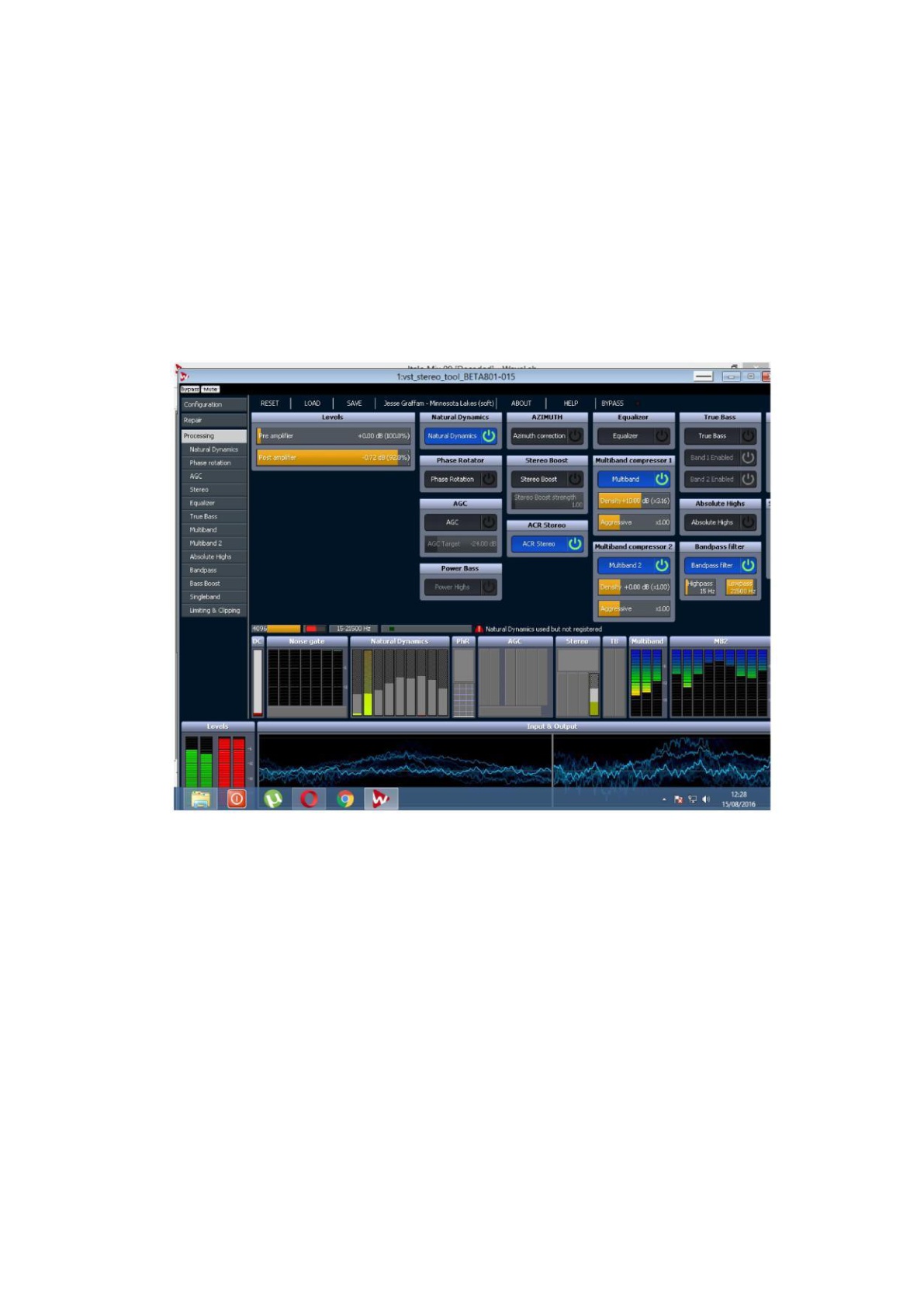

Posts: 42
Hello...
This is distorsion?
Pretty Girls in your city
PostPosted: Mon Aug 15, 2016 7:33 pm
Yes it is. But it's an easy one to fix. Go to the main Processing tab and lower the "Post amplifier" setting a tad, until the red goes away. Alternatively, go to the "Limiting/Clipping" tab and enable Hard Limit. Either solution will get rid of the red for you.
