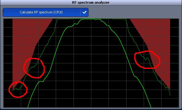

Bojcha , thank you for remind me for RF spectrum
Here is what some body said "Signal is very small down at least...."
Here is what it looks like in the RF spectrum. I mean problem with L+R down side slope ( from now i will call it "the oversignal")
And here is what it causes.
