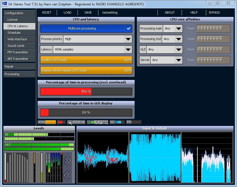

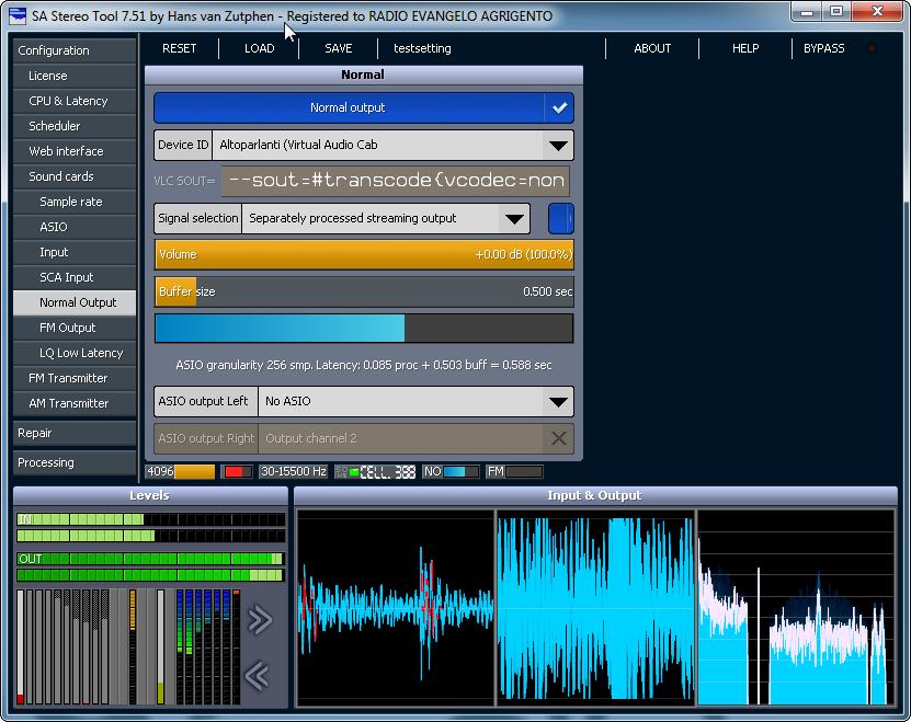

PostPosted: Wed Dec 17, 2014 6:08 pm
Joined: Tue Dec 16, 2014 9:11 pm
Posts: 12
I noticed that if in normal output the signal selection is set from "de-enphasized version of FM output" to "separately output stream" the cpu load changes from 55% to 66%. (ST 7:52 beta17).
Sorry for my bad english.
You're saying it changes when you *connect* a transmitter? That makes no sense... unless something is wrong in the connections or the sound card. You're not talking about turning FM on and off? Because then it could very well be.
cpu load 66.3% with separately streaming output.png [ 110.58 KiB | Viewed 4990 times ]
