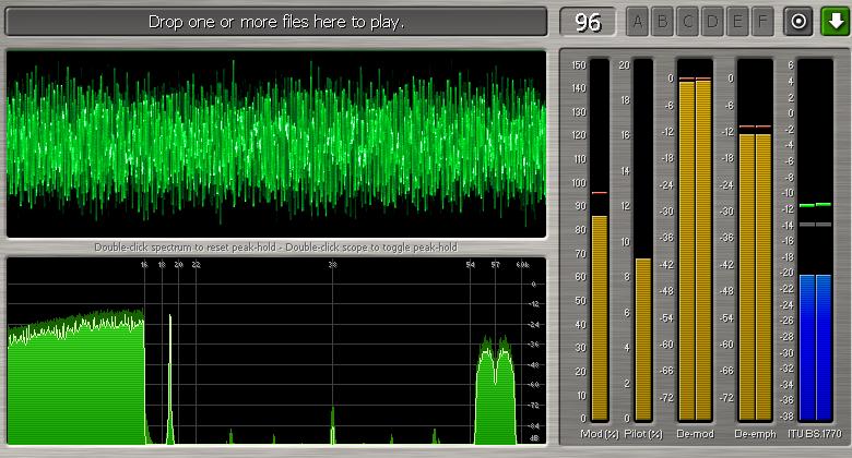

I found strange artifacts in FM mode at 22-54kHz (if LPF is at 16kHz)
Pink noise at input.
This darker green is peek hold.. because this comes sometimes. about once per 5 sec.
I also found that is generated by loudness filter.
PostPosted: Mon Sep 05, 2011 2:13 am
With white noise is almost good ... only in two frequencies i have little artifacts around -85 db.
But when enable this distortion protection some artifacts in the middle appears in that band of 22-54 KHz yeah . Little but there
Bojcha have eyes of an eagle :)
See picture .. on the both sides is when no protection ON
in the middle appears when protection is ON
PostPosted: Mon Sep 05, 2011 2:17 am
Bass is causing this to loudness filter... so white noise is ok.
PostPosted: Mon Sep 05, 2011 3:10 am
Looks like the 2 channels are not handled exactly the same... So there can be small differences between left and right.
-> Update: Yup, it's Improved Bass Distortion Protection and Very Deep Bass Distortion Protection.
PostPosted: Mon Sep 05, 2011 4:38 am
Fixable?
