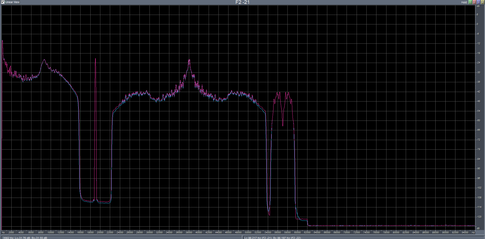

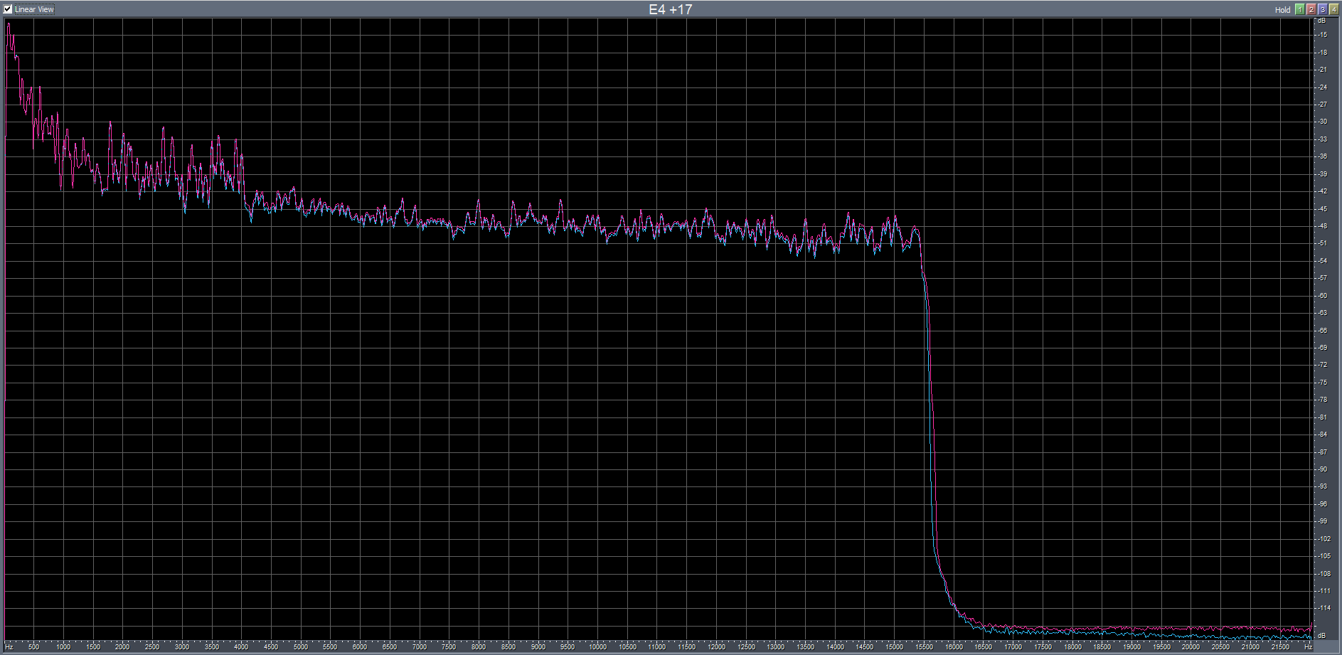

I have just compared the output of version 7.70 (released) against the latest version, and what I see is this:
There is a VERY small area of extra highs present, and that's on purpose - I discovered that my LPF filter that's placed after the clipper was removing too much signal, which caused the total audio level after Hard Limit to be about 0.02 dB softer... Not much, but that effect is gone now. The reason was that the LPF was doing exactly the same thing as the HPF before the clipper, which means that it removed more audio. I've moved the after-clipper LPF up by about 100 Hz. (More at lower latencies).
@DJ_DOGGY: This doesn't look at all like what you are seeing...
Btw, I don't know why the hiss level is about 0.5 dB higher...
O, and there's no pilot visible, but this is the audio that's going into the MPX encoder. It's a bit more difficult to get the MPX signal out... I can tell you though that I also don't see that slope in the MPX display in Stereo Tool.
I`m showing the very last Output , not anything else . As you see , there is a difference .
I made it with absolutely same conditions .
The two pictures are made with and without Advanced clipper . So Advanced clipper causes what i`m able to catch with SpectraLab. And i`m sure that it`s from little dostortion . It`s also visible into the DeEsser indicator , when you feed with White noise. Test again and see the peaks that appear . I make Strictness of Advanced clipper to 20 - it helps and clears this effect !
If this is CPU sense problem , then test it with some AMD .
This must be corrected at least . I forgot to mention that the two pictures are made with Strictness 6.
I can make a video of the two version i test , so to see that there is something to be corrected. Yes i know there are code modifications for CPU load otimization , but the result is almost there (just little difference).

@DJ_DOGGY:
I did just find a small bug which must be in the final step when using 'Ignore frequencies above'. This is causing soft clicks in the sound (around -100 dB). That's the jumping noise floor that you mentioned. I will look into it.
However, I'm not seeing the behavior that you are showing. Which looks bad - it definitely shouldn't happen. However I can't reproduce it here. Can you send me the settings that give this behavior?
This is what I'm seeing, version 7.70 RELEASE vs. 7.71 BETA015:
Note: This is with composite clipper. Your samples are without, but when I turn it off here the output looks almost the same (just softer).
