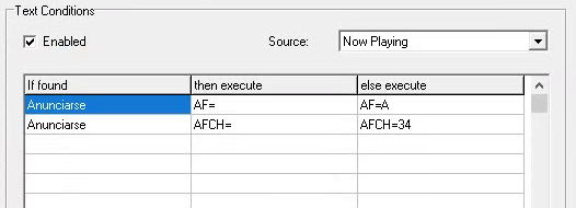

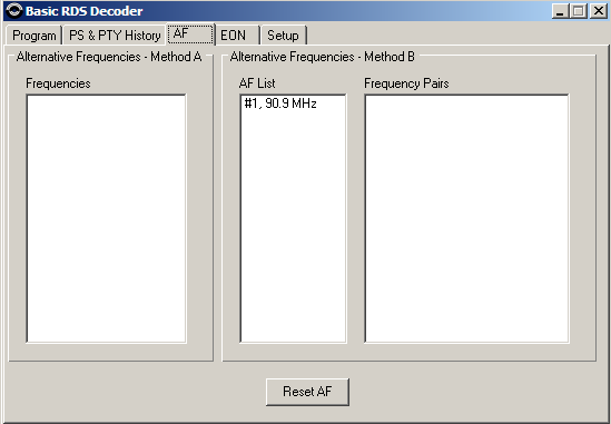

Testing with StereoTool latest BETA. The AF frequencies from MagicRDS is not right. For example, RDS Spy returns 90.9 FM as an alternate frequency, but I've set up MagicRDS to push 92.7. Also MagicRDS is set up to use AF method A, but RDS Spy is returning B. I'm currently not able to fly to Spain because of an accident I recently had, but is RDS Spy reporting right or not?
Using UECP ASCII mode.
See attached images. I've setup when there is a specific title in the Now Playing TT file to disable the AF function (return no AF channels) and otherwise return AF=A & AFCH=34.
All other RDS functions are working properly.
Best,
Patrick
I'll check what's wrong tomorrow. AF method A or B are identical in how they are transmitted though, so I don't know how RdsSpy can determine which of the two it is.

I've set up the AF frequency in the dialog "AF", and monitored the Command Log Windows for what command is being sent to the UECP port.
But it's not 90.9, it should be 92.7 which is 34 in MagicRDS.
Or you should make a command available to the StereoTool GUI to disable AF with a special command to interrupt the AF's while broadcasting ads. Maybe a good idea?
PostPosted: Wed Jul 11, 2018 6:06 pm
Posts: 11520
No, that's just not how the standard works - if you only do it during ads, chances are that receivers will still switch (and many even completely ignore AF method A and just look at PI codes anyway).

Ahhhhhh!!! 34 is a hex number. 34h = 52. See, that's the problem with ASCII mode, it's not clearly defined what's what. Meaning: someone else could easily be using decimal numbers.
There is a better way, but it's complex, the 2nd digit of the PI code together with AF method B should be used to tell receivers when they can or cannot switch.

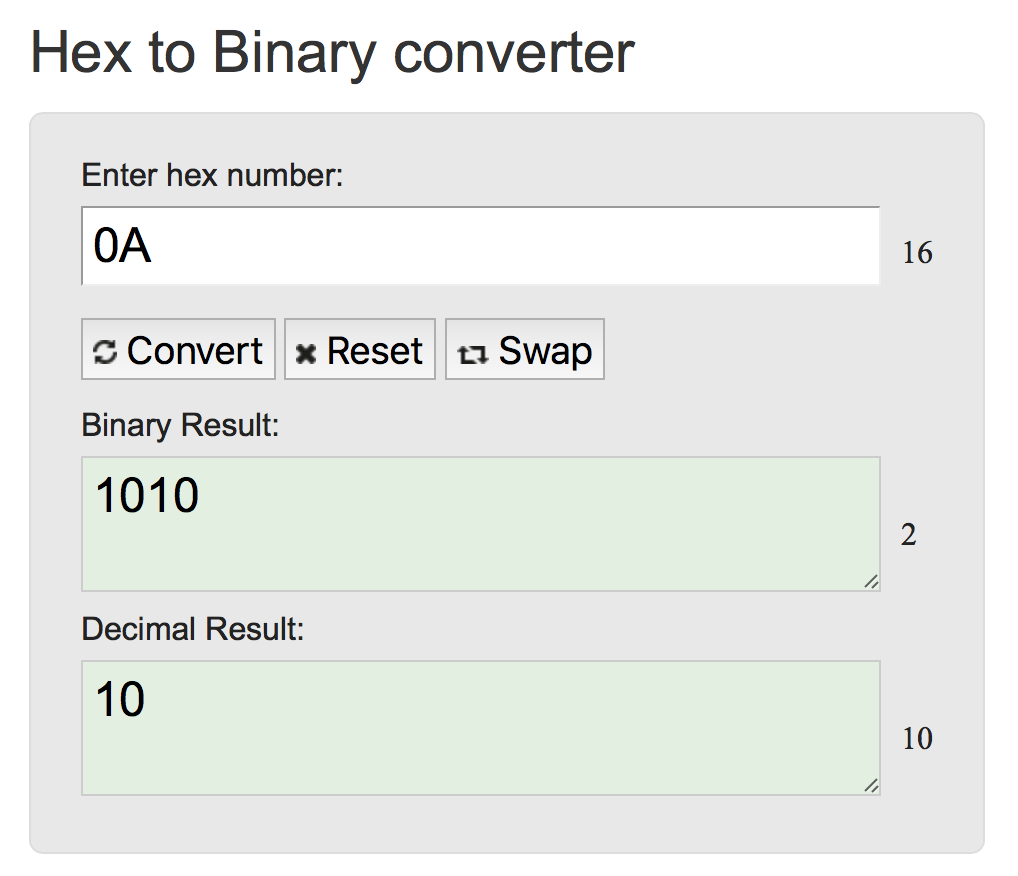

92.7 is 52 and 9 is 88.4 FM. Confusing haha...
Some kind of 'ASCII Command mapping' Window inside of StereoTool would be amazing. That way you can let everybody work with the ASCII Mode without making different functions inside your own code when you discover an other piece of software!
This advice is free ;-) Haha.
Edit: now I also get why the PTY in RDS Spy was on 'Weather' instead of 'Pop Music'. Changed PTY to 0A instead of '10'

Ok. "Small" problem then: Other programs DO use decimal numbers and they use the same command. And some might use a mix. Ugh. So how do I support both??? Without adding yet another selection, that nobody will know what to set to :(
(By the way, Windows "calc" can do these conversions!)
