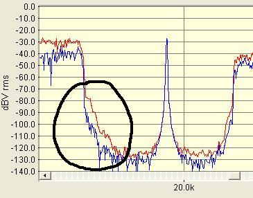

I must report that now "side" of L+R is worse than previous betas.
See the picture.
Please to refer only to the red line , because it is holded for a less than second so the shape can be seen.
Even with Strictness of 20 cannot help to remove the showed (circled) on picture.

PostPosted: Fri Jul 24, 2015 3:47 pm
I don't even get it. Aren't we just looking at a 19k pilot? Does this even occur in non-FM modes?

Yea but on that image i dont see at all l+r area..
PostPosted: Fri Jul 24, 2015 3:52 pm
I again will say : DO NOT look at the pilot ! LOOK AT the right side of L+R signal ! There is "side effect" that NOT exist in the beginning of developing this 7.71 version , neither any old versions . Now get it ?

Look at the last image . You don`t need whole L+R . You need only to see the shape of the end of L+R. I`ll edit the picture and circle the zone .
PostPosted: Fri Jul 24, 2015 3:56 pm
Yes, please circle what you're worried about. From your explanation, I guess you're worried about that upslope around 24k? Also, what is your lowpass at right now?

My worry is at the cut of the lowpass . I already circle it . Refresh page and see.
Yes it`s the upslope but not at 24k. Filter is at default for FM 15000 Hz
This is caused by new modifications of Advanced clipper . It allows a little distort and this is the effect. I can show you old version that NOT allow this and this effect is "zero"
This is NOT caused by the lowpass itself - TESTED!
PostPosted: Fri Jul 24, 2015 4:10 pm
See the difference ?
This is with Advanced clipper OFF and only Bandpass active ! Perfect shape, perfect slope

At least it's so low that it's inaudible.
