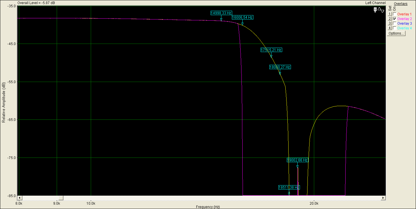

PostPosted: Fri Mar 25, 2011 1:50 am
This is measured from the audio output from the tuner. I did a sweep from 30 Hz till 20 kHz and used a LPF of 16 KHz and one of 18,5 KHz in stereo tool.
It's about 10 dB's down at 17,5 KHz and 15 dB at 18 kHz compared too the flat line.
