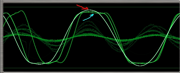

PostPosted: Wed Aug 23, 2017 11:02 pm
Ok here is picture..
Blue is clipped bass from bass clipper, Nicely visible
Red same bass boosted by limiter.
Settings are -2dB max bass and clipper drive to +4
That red marked bass is gone if i just turn off limiter.
PostPosted: Wed Aug 23, 2017 11:04 pm
That's not being boosted by the limiter. That's unclipped!!!
PostPosted: Thu Aug 24, 2017 12:39 am
Ah so limiter is actually declipper.
PostPosted: Thu Aug 24, 2017 12:44 am
Well that's what your blue arrow seems to be pointing to.

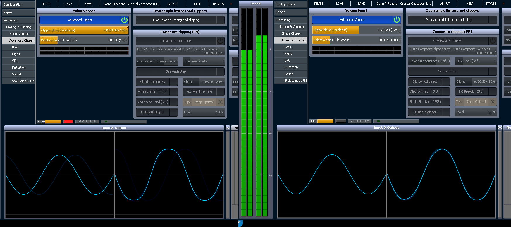

PostPosted: Thu Aug 24, 2017 12:49 am
Posts: 11516
I just tried it again with a 30 Hz tone. And I set "Dirty Bass" to 100% and Controlled Distortion to the maximum. Bass clipper at -4 dB. Everything else at default settings (but Advanced Clipper and 'Limit instead' enabled).
When I increase the drive, the waveform becomes more flat, but the peak level does not move at all. So it behaves exactly as it should.
