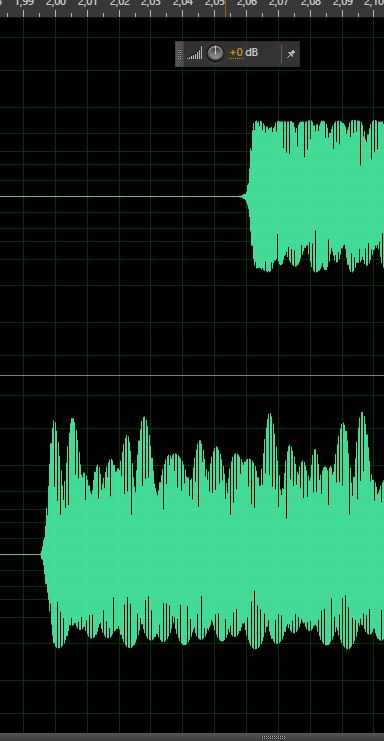

I've just tried the version 19. Strangely, thereby enters exactly the same effect as on the version 18 Here, too, I have again attached a picture. Am I doing this new feature, so it's absolutely fine. But somehow it seems to be true still not quite.

I'll have to check what I return as latency in the VST version. I did test the command line and DSP versions and there everything was fine; I'll check if my VST delay calculation is different.

Confirmed: There were not 2 but 3 places where the audio delay was calculated. And I missed the one for VST files.
(Until now the calculation was just the delay setting in the GUI, but for the delossifier I need to add 2.5 MP3 blocks of 1152 samples each).
7.42 is already released now, but I will fix this in 7.43 (which I think will be available soon, probably within a few days). For now, keep the delossifier turned off if you don't want to have this shift.
