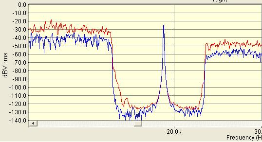

Clipping is the same . Advanced clipper still distorts compared to the last stable version.
This is not from low pass ....Tested.

In case you don`t understand for what reason i put these screenshots
Put in a "white noise" to ST, take a look at the DeEsser indicator (tune it to 0.00dB or 87000) and see the little "grey" peaks that appear on the right side (not the yellow fill).
These peaks are unwanted.
I have screnshots with white noise from latest beta and from old version.
If needed i`ll upload them.

Yes , i understand but it`s not about the 19 Khz . It`s about the down-right side of the L+R signal ,respectively both sides of L-R . Thereis unwanted signal after the value of highpass filter (mostly 15000 Hz) growing up to -80/-75 dB . This signal not presented in older versions. May be this fine tunning you talking about, will eliminate it? Will wait for next betas and test (report).
I test it with music too (it`s clear on scfreenshot). Other issue with Sparkling and Ignore freqs is out of this screenshots and are another issues.
