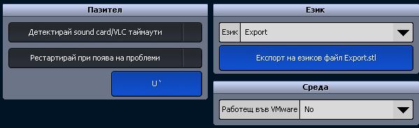

The new password option in Configuration panel is "compress" the space for the other buttons and some translations are almost cut at full screen. . Is there a way to minimize this new (unuseful) option a little.
PostPosted: Sat Dec 13, 2014 3:47 pm
I don't see what you mean here, can you make a screenshot? Thanks...
PostPosted: Sat Dec 13, 2014 4:20 pm
This is the button - translated just with 2 more letters, but was Ok before add the new password option. But when in English , the Watchdog texts are almost at at the cut . Looks a little ugly like that for a long button.
