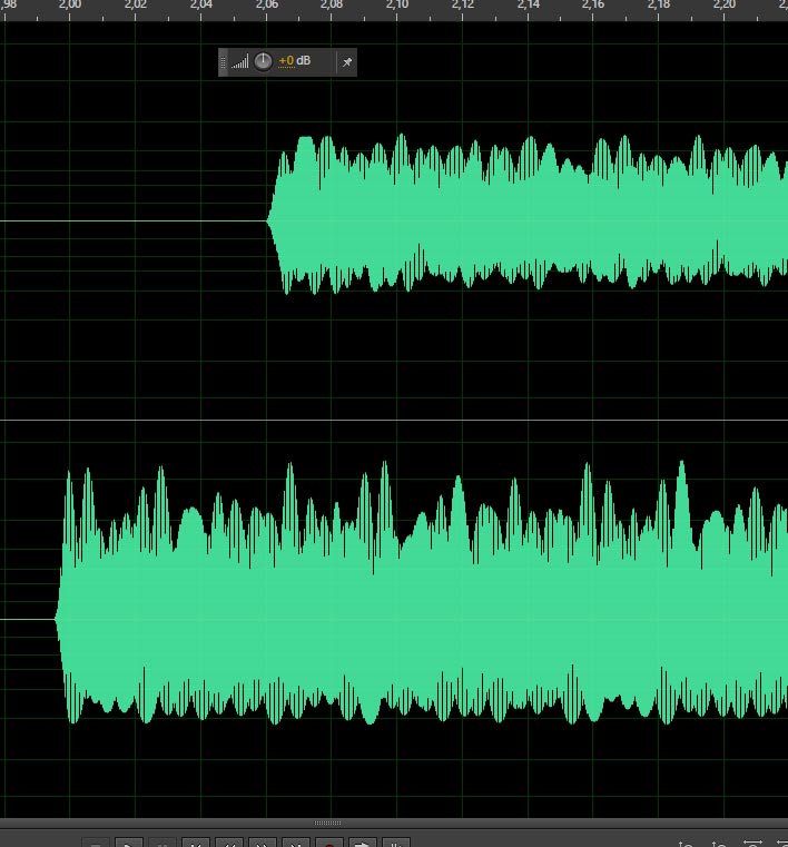

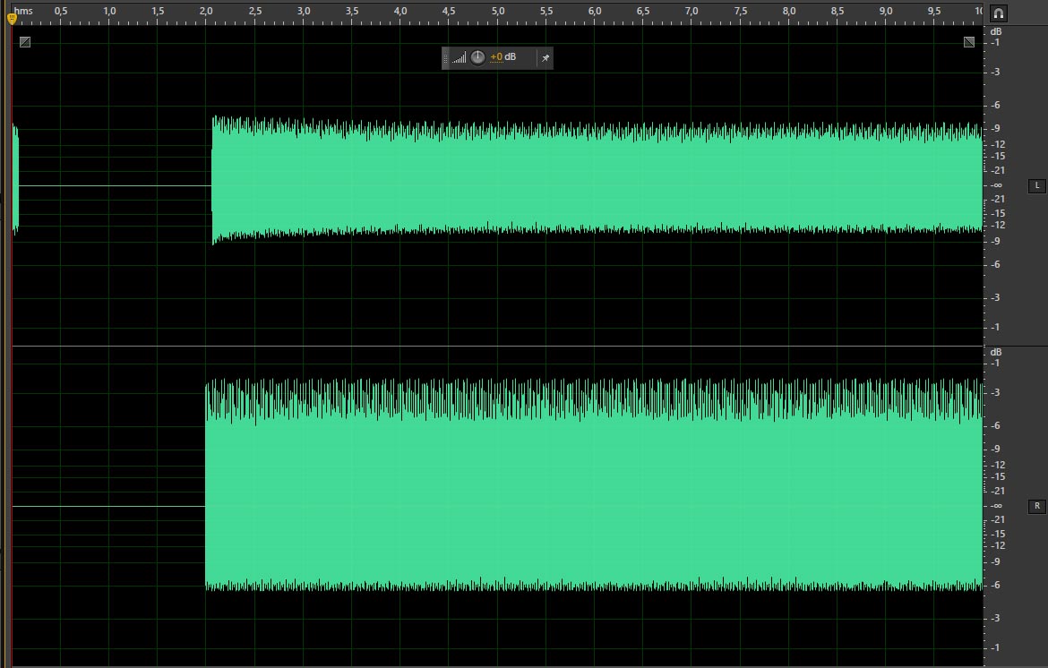

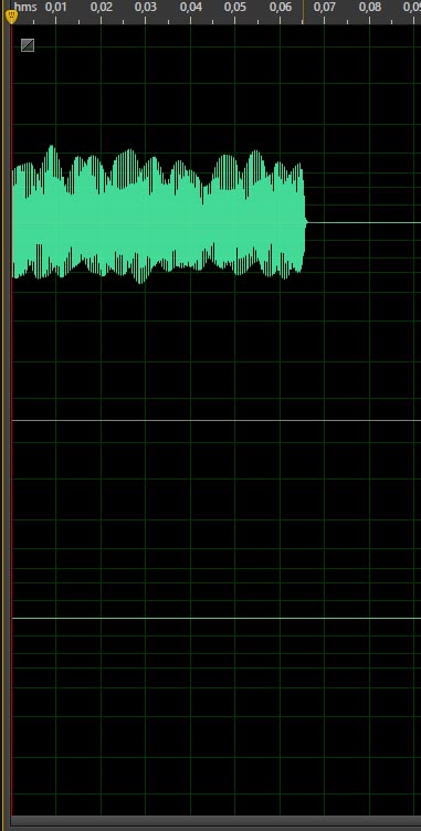

Hello,
I have now tested the new VST 64-bit version. So far I have not had any crashes, and the new feature is also very good!
But I have found that there is a time offset. In addition I have even created a test file, which is exactly 10 seconds. This I then used with Stereo Tool and the PerfectDeclipper. Finally, I put the original signal on the right channel, and the revised on the left channel.
And I've found the following problems:
1 At the beginning of the revised file, there are strangely Audio, obowhl there was none at all before.
2 There is a time delay. That is, the audio is shifted to the rear. This is very ugly, because that is so, the end is displaced and missing.
For the problems I once an image is done. The Delay is 0:00.063

@near05:
This happens when you enable the DeLossifier. Fixed in this new build (I decided to run one more build before releasing, to fix this issue and to update a few presets).
