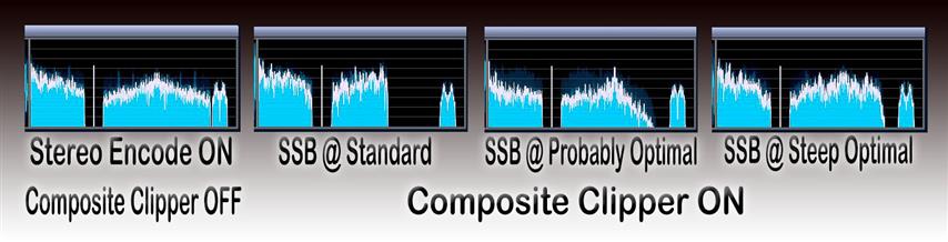

This is how it looks on my 6 core 12 threads.

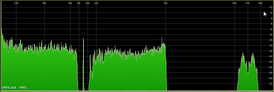

There's been some discussion of what the SSB looks like in terms of how much if any is left above 38khz. FWIW, this is what the Omnia 9's SSB looks like:
