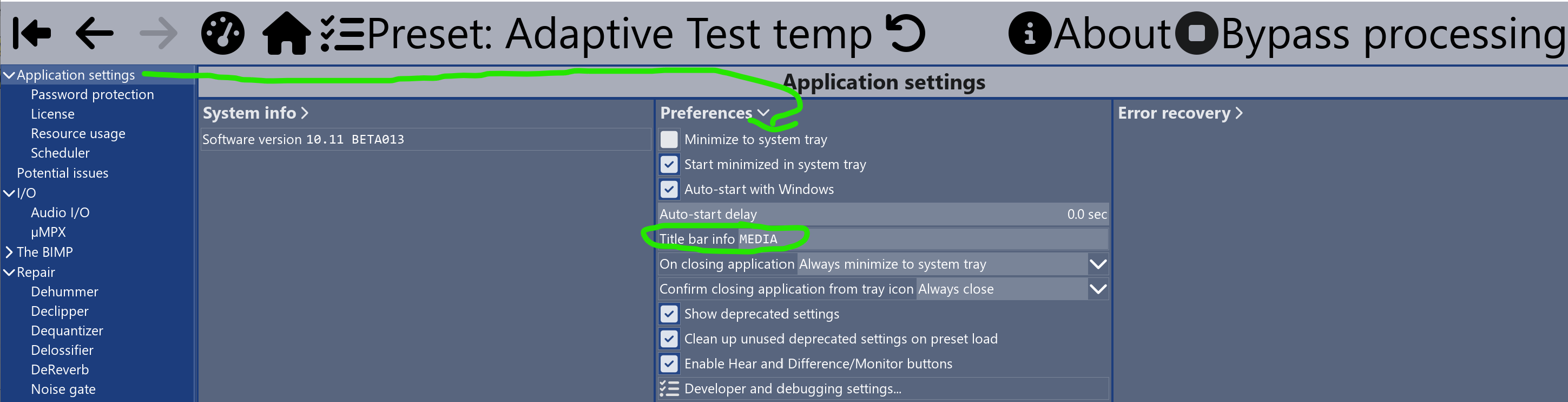

One question: in 9.92 it was possible to assign a custom Window Title to the running instance, and because I am running two, it was a handy feature. Has that been taken away? Thank you!
Nope. This is in Application Settings > Preferences > Title Bar Info.
Don't forget you can expand the > icons

Ah, I've been behind the curve and posting to the old beta thread. I'm testing 10.11 Linux standalone JACK.
Under Application settings I find: Password protection, License, Resource usage, Scheduler. No find Preferences, and no find Title Bar Info.
It's in the main pane, not the left pane:

Ugh. I am not as observant as I wish I was. Yes yes yes, there it is. I will be more careful to pay attention. I apologize for wasting bandwidth here.
