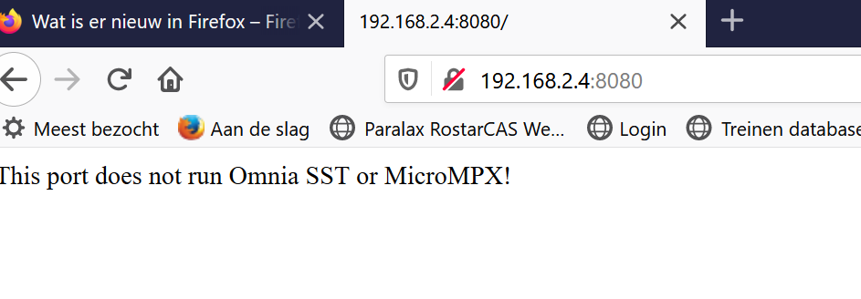

We are working on a new web interface that will - hopefully - work much better with screen readers. For one, it will allow typing in a number directly instead of moving a slider.
Sounds great, thanks for all your hard work. The web interface in beta 38 however gives me the following message and nothing else.
"This port does not run Omnia SST or MicroMPX!"
I'll try one of the earlier betas, just thought I'd let you know.
[update] The newest version I can get it to work is beta 032.

When trying to use the webinterface i get a white page with the following text: This port does not run Omnia SST or MicroMPX!
Kind regards,
Arkadas
PostPosted: Fri Feb 21, 2020 9:14 pm
Kind regards,
Arkadas
Confirmed. I'm seeing that here, too.
