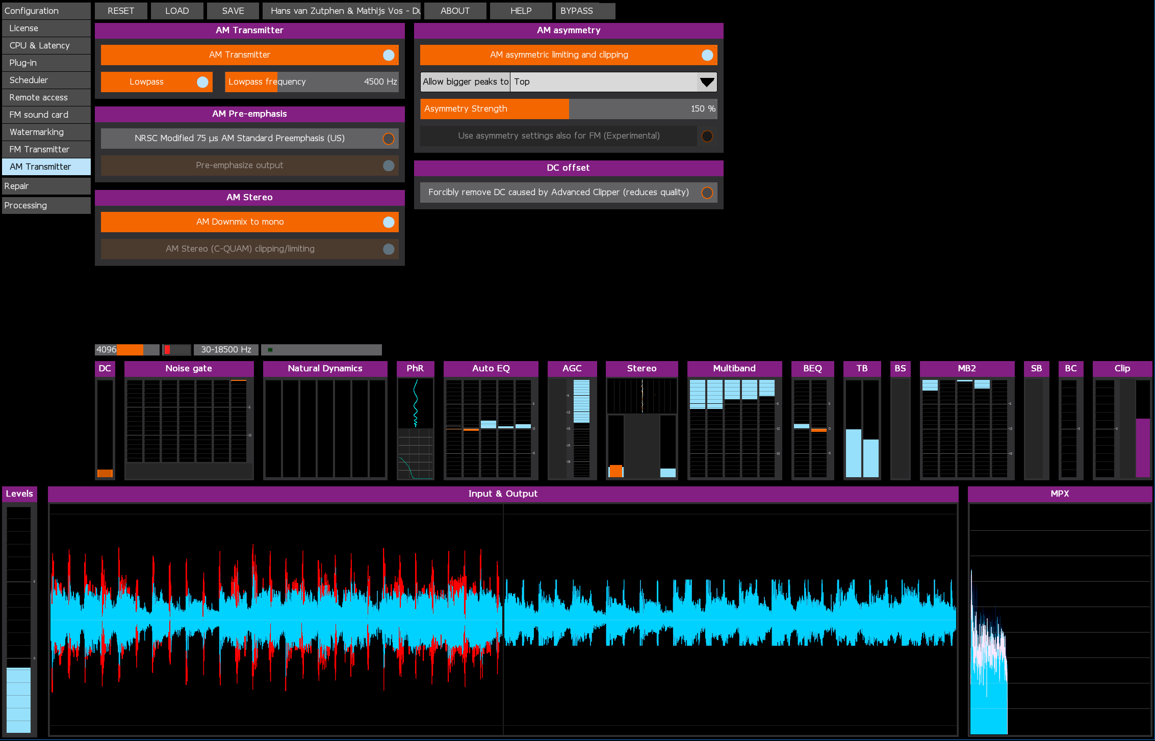

hello Hans
did you test it???? if yes what did you see??
there is a problem with the AM mode.when i,m change the low pass frequency in AM transmitter does not change in the bandpass filter at the same time so i have to go there to put the value manual ....in FM mode this works fine ....can you fix this???
regards i,m testing the new beta..
PostPosted: Wed Oct 03, 2018 4:51 pm
Posts: 11443
With normal audio I know it works. But, if adding asymmetry would cause artifacts (and that might very well be the case in this specific situation) then it won't do it. I'll have to test it (I can probably look into it tomorrow) but I've used asymmetry mode last week at the IBC and it worked fine there...
hello Hans
Hm, the AM lowpass filter definitely works fine here. If both these things don't work: Are you 100% sure that AM is enabled correctly? FM needs to be disabled.
This is what I see in the latest beta, AM enabled, lowpass set at 4500 (and you can verify that in the right bottom display), asymmetry set to 150% to make it very visible that it's really asymmetrical.
