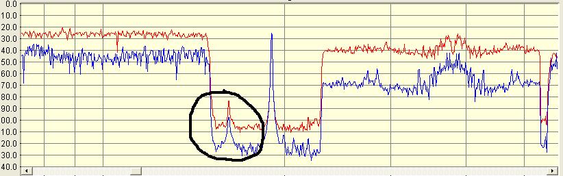

A small unwanted signal ONLY when enable the "Sparkling highs" checkbox.
For the old bugs - Yes, distortion is fixed , NAN bug is fixed too . Confirmed!
Edit : CPU load is now OK . Even better!

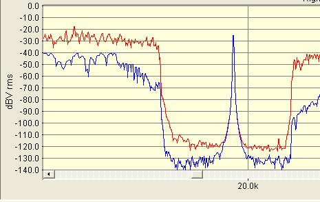

Also one small report for the "Ingore highs above"
When enabled and slider is moving below the default 19000 to 16000 , this signal is moving with it. It`s exactly the frequency you set with the slider . If you set it to 16000 , then this signal is at 16000.
This may be useful : When slider is moving above 16000 , this signal is getting weak . Weak of this signal is is proportional to the moving of frequency. At 24000 i cannot see it.
Hans , confirm you saw all this report because i edited it many times.

Yup, read both. For the 1st unwanted signal, "Protect Tones" should help, and you might need to set Punch/Distortion to 0. When playing music that might sound less good though (loud tones are kept pure, which might make them cause holes in the other freqs).
The 2nd one I still need to fix.

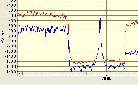

PostPosted: Sun Jul 19, 2015 4:25 pm
Is there any change in steepnes of highpass filter ?
Or it`s from the changes in Advanced clipper (i think it is).
Check the difference. Old version has perfect steep.
New one allows some distortion , right ?
Compare the red lines .
