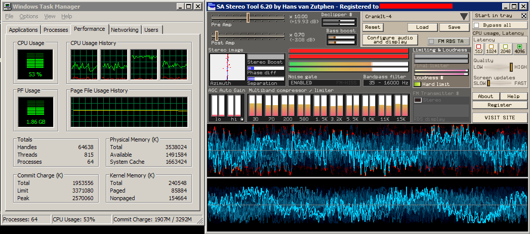

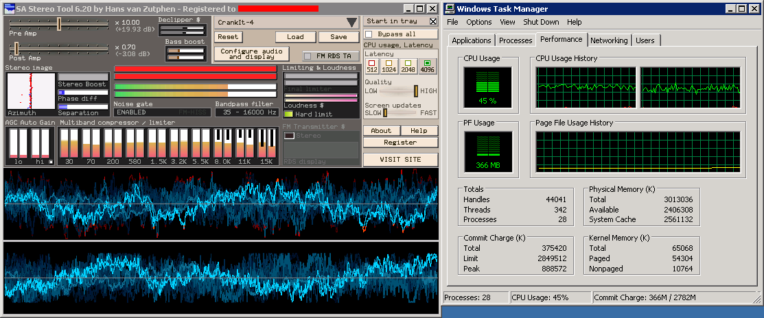

So what is screwed up?
The motherboard ... probably... it's changing the CPU multiplier "on the fly" when it's under some load. If it's completely idle, it runs at full freq.
Before on the backup server I couldn't run Stereo tool with declipper or any CPU-intensive option turned on.
The main server has the same problem, but it's only noticeable if it's under 80+% load, but the backup changes the multiplier down at load above 10%.
