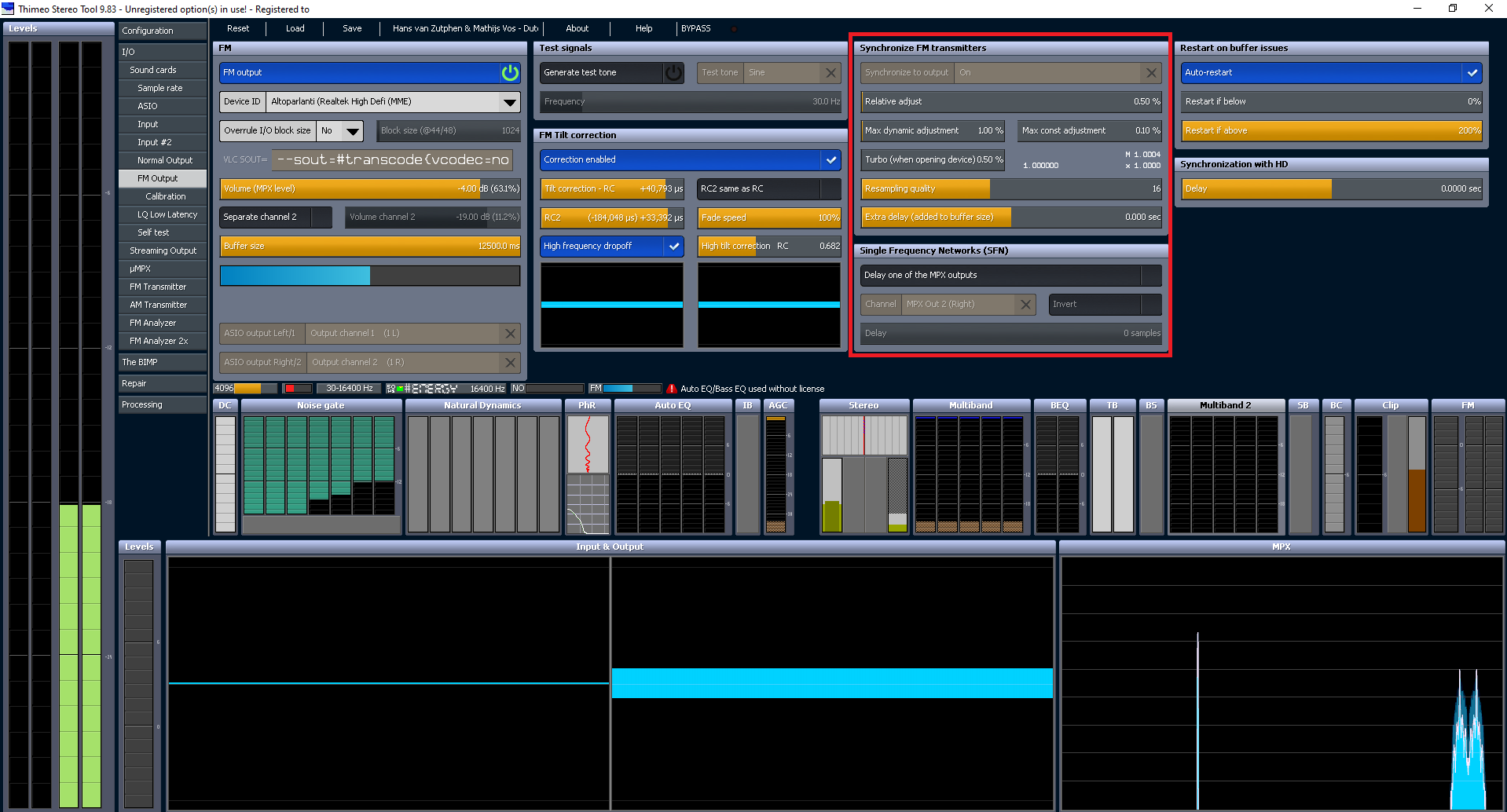

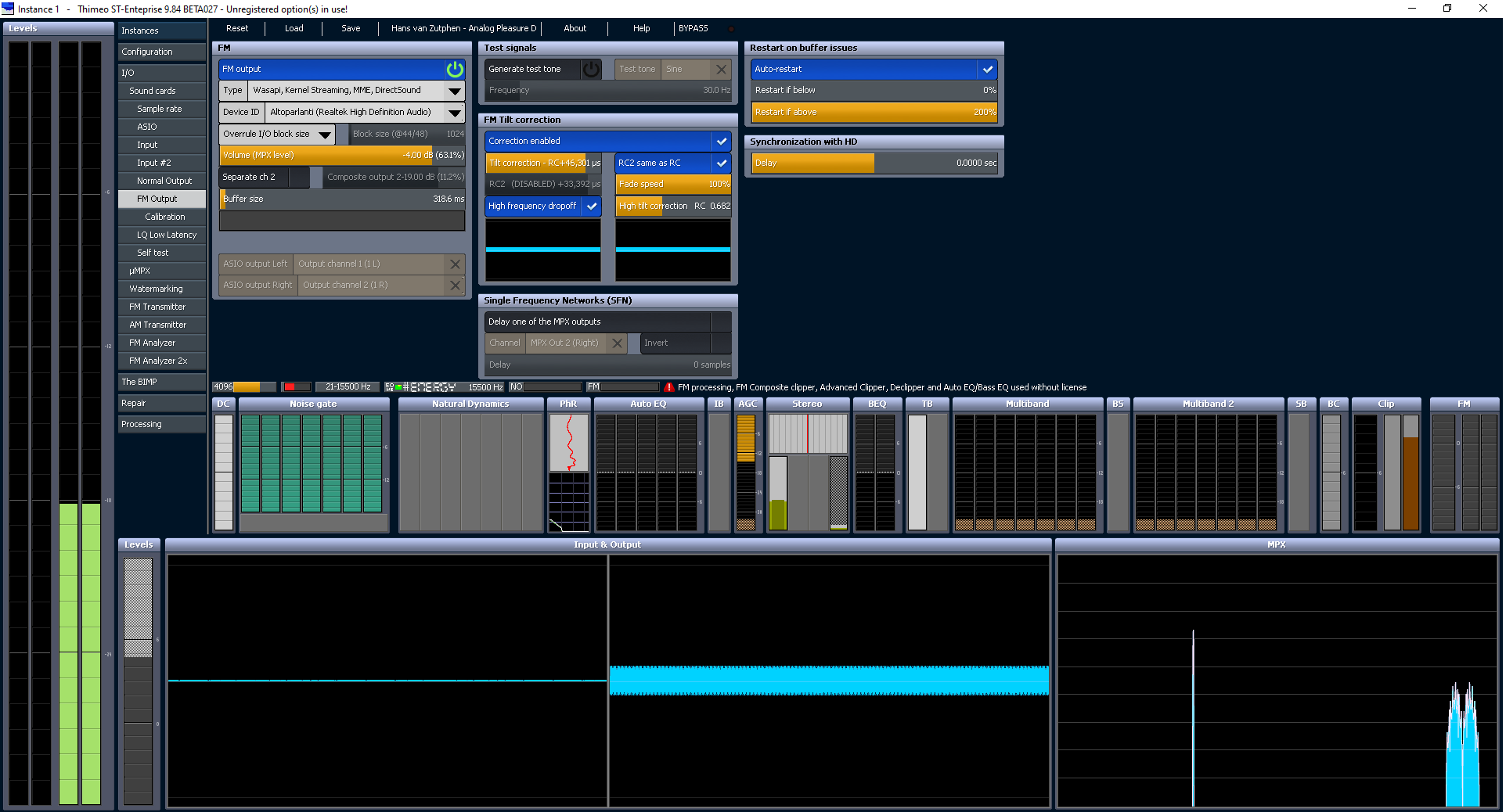

maybe I explained myself wrong.

PostPosted: Mon Feb 21, 2022 11:28 pm
beta 27, now i see aes67.
but I no longer see the synchronization in fm, is that correct?
That should never have been there. The input syncs to FM, not vice versa (that would cause pilot/RDS issues).
Found what's causing this. The FM sync is basically the same thing (!) just with more settings as the input sync - if both input sync and FM are enabled the settings are shared between the two, and you can actually change the settings under FM to control how the input sync works.
We've made this FM sync thing for when you're using a streaming input. And that's not yet supported. That's why you don't see the settings...
