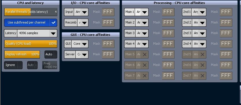

All clear. I have now deactivated everything, and yet there was this phenomenon.
I just noticed something that I hadn't even noticed yet. I had 4 threads set in the CPU settings. According to the display, this adds an additional delay. I have now changed this back to 1 and reset it all. And now the behavior has completely disappeared (just by turning off the phase delay, of course).
That means the actual cause is my CPU settings > 1 thread. Can you see if you can do that part of it yourself? I added my original settings as a picture to this tab.
My guess is that you don't pass this additional thread latency to the VST client. As a result, these phenomena also occur with the help of the factory settings.
I would never have come up with it in my life, but only after I had reset to the default settings did I notice this in the CPU tab.
PostPosted: Mon Jan 15, 2018 6:23 pm
Aaaah! Crap, I completely forgot to compensate for that. Ok, now it's easy :)

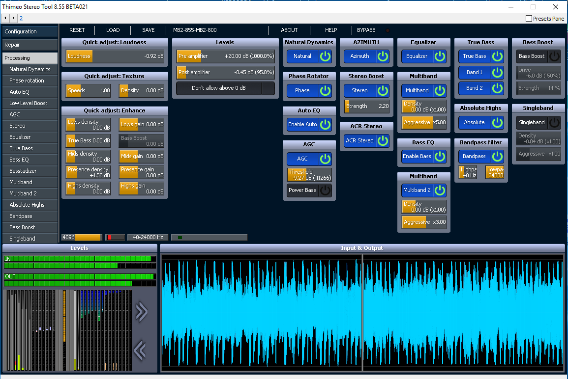

Advanced Limiter still not showing in Foobar, unable to test this way.

JdR2, if you have 64 bit Windows, one thing you could try for now is loading Stereo Tool into Foobar via jBridge. Set it up saying you want to use a 32 bit host, then select the 64 bit StereoTool VST.
Finally, after you have started it at least once, use these settings:
(In C:\Users\[username]\Documents\jBridge\SettingsFilesFor64BitPlugins)
//EXPERTS ONLY - unless stated otherwise: 0 - disabled ; 1 - enabled ; all other values will be ignored
-Reload the plugin for changes to take effect!!
AUDIOMASTERGETTIME_HACK 1
USE_IPC_THREAD_SAFETY 1
FORCE_GUI_REFRESH 0
SLUGGISH_GUI_FIX 1
FORCE_CHILD_WINDOW_CLIPPING 0
RUN_IN_EXISTING_AUXHOST 1
CRASH_DETECTION 1
//( not listed in the settings menu )By default, all the plugins who have the "run in existing auxhost" option enabled will be in group 0, if you wish to group specific plugins in different auxhost's, change this value somewhere between 1 and 64
RUN_IN_SAME_AUXHOST_GROUP 0
//( not listed in the settings menu )Set this option to 1 if your bridged plugin hangs when loading a project.
EFFSETCHUNK_COMPATIBILITY_OPTION 0
//auxhost priority(experts only!) - 0 is default ; 1( lowest ) to 7 (highest) ; all other values will be ignored
AUXHOST_PRIORITY 0
//set to 0 to disable "forcing auxhost termination(...)" message
MAIN_HOST_ERROR_WARNING 0
//uses v1.2 integrated mode implementation if 1 ( enabled by default for backward compatibility purposes ).May need to be set to 0 for automation to work in some hosts (i.e., Ableton Live)
LEGACY_INTEGRATED_MODE 1
//Plugin's GUI will be opened on a separated window if set to 1
USE_SEPARATED_GUI 0
//Auto-closes the plugin's GUI when the settings window is closed (Separated GUI mode only)
GUI_AUTOCLOSE 0
//Audio buffers will be processed asynchronously, can improve performance with some plugin/host combinations
PERFORMANCE_MODE 0
//Set to 1 if you're experiencing opcode 19 error messages
OPCODE19_COMPATIBILITY_OPTION 0
//Set to 1 if you're experiencing long delays and an opcode error message when closing/re-opening the plugin's GUI
PREVENT_MAIN_HOST_WINDOW_CONTROL_ON_GUI_CLOSE 0
//Set to 1 if you're experiencing crashes when unloading a bridged plugin
DIRTY_CLOSE 0
//( separated GUI mode ) keeps the plugin's GUI window always visible if 1
GUI_WINDOW_ALWAYS_ON_TOP 0
//( not listed in the settings menu )Experimental option, disables processing of deprecated opcodes if 0
USE_DEPRECATED_OPCODES 1
//Loads the plugin in GUIless mode ( for plugins that have no GUI, when used in a VST host that supports those ).
//You will not be able to access jBridge's options if you change this to 1 without editing the settings file and changing it back to 0
REPORT_NO_GUI 0
It does crash occasionally because of the window size issue but if it happens it will happen right at the start. (Your mileage may vary.)
