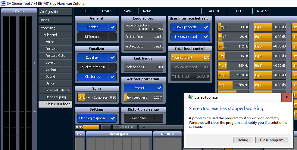

Last beta won't start on windows 10, beta 8 no problem.
Which version (stand alone, DSP, VST)? And do you get an error message? What happens exactly?
Windows standalone..first when installing error..downloaded it agaun and install went fine.
But at startup directly: stereotool has stopped working
Can't see any error code or something

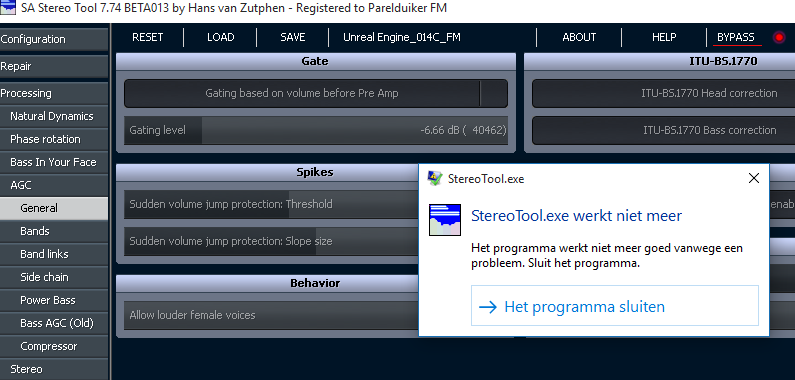

Here also beta 013 ( standalone version ) stop working Windows 10 64bit.
when i push "bypass" then Windows 10 throws this error because of a problem, but Windows does not say what problem :|

Ok. I'm unable to reproduce this crash here so far. :( If anyone else sees this, or if you DON'T see it, please post it here.
If you see a crash, could you send me your .ini file, so I can check if that makes it crash here as well? Thanks!

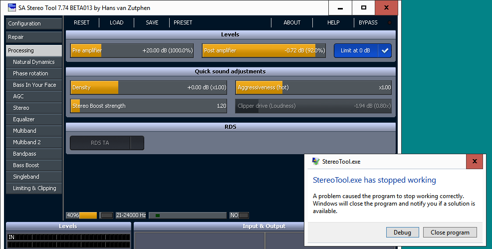

Stereotool Standalone Beta013 Crashed In Windows 10 64bit, I Restarted the PC and Even Delete the stereotool.ini NO Change Expect for the Interface and Seeable Settings.

Hm, either a lot of people are using Win10, or this is really a Win10 issue... (Which would be strange, I didn't do anything even remotely related to Windows versions, and until now it worked - how big is the chance that I just broke something now that only affects Win10?)
