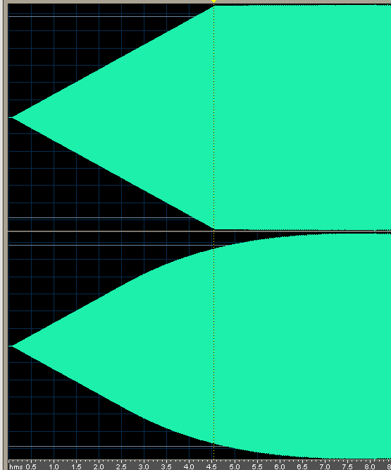

PostPosted: Tue Jan 22, 2013 8:26 pm
@Bojcha:
Knee:
- Input 1000 Hz tone, rising level.
- Loaded defaults
- Threshold to -16 dB
- Ratio to 1000:1
- Feedforward (so feedback to 0%)
- Top: Knee 0 dB. Bottom: Knee 10 dB. Output is normalized.
Looks fine to me?

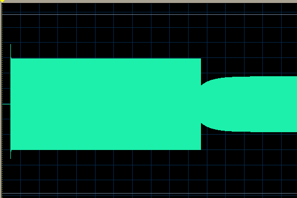

PostPosted: Tue Jan 22, 2013 8:32 pm
Default settings in beta16 - http://i.imgur.com/T3IBha3.png
More threshold (~-18) - http://i.imgur.com/Lv2VXSc.png
testfile 0dB sine, then -8dB.
0 dB & -8 dB, default setting, set "Dynamically release to 0 dB" to 0, threshold to -18 dB:
Also looks good to me?
I've also tested -54 dB and it looks nearly identical.
