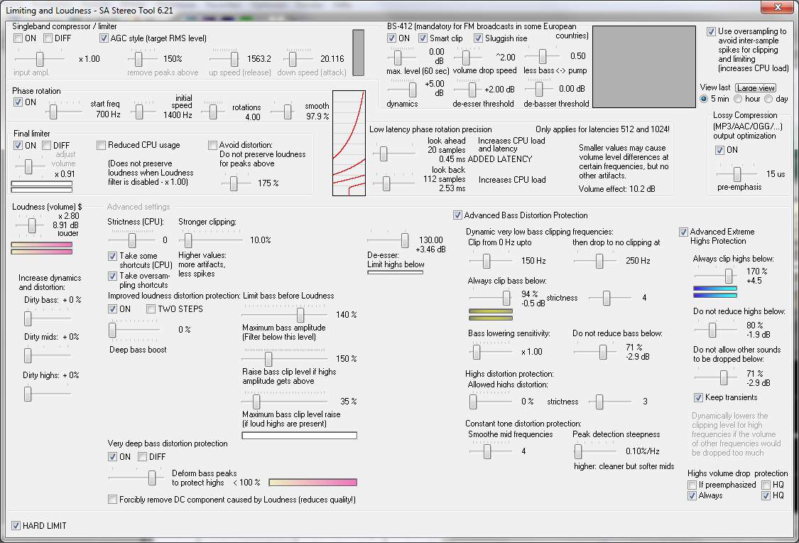

Hello,
you want to know why i always use this song? it's very simple, because it has S-Sounds and hithats.
here can you hear the part in the original version:
original.ogg
In the Original Version there aren't holes and it sounds ok.
the settings i use in the loudness section can you see in the attachment.
i am not shure if i save the preset if all new settings are already saved correctly therefore the image.
hans: do you have an idea why i get only in this part this hole?
PostPosted: Tue Mar 06, 2012 6:30 pm
It's not only about loudness.. depend much on MB..

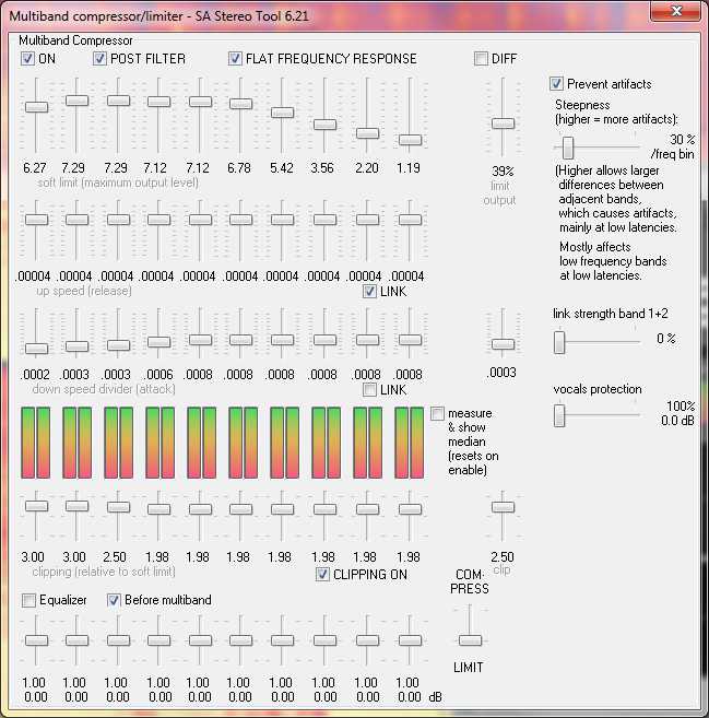

PostPosted: Tue Mar 06, 2012 6:44 pm
Hmm thats quite interesting. I now turned of the Compressor and used only the loudness Part. Now the hole is gone :oops:
I am sorry for that...
I am using a pre-amp of 40 db. then i use the settings you see in the attachment in the compressor.
I'm really very sorry
