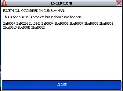

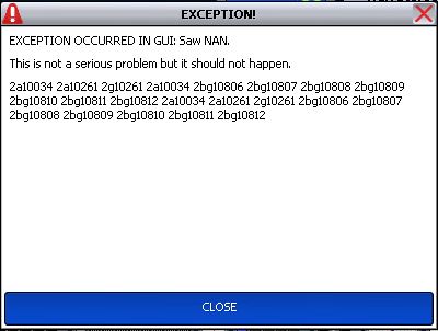

Thank you for the description! I have included another NaN exception, which happened again by chance.
PostPosted: Mon Jan 15, 2018 2:00 am
10034 = Advanced Clipper. 10261 = Bass Boost. 10806-10812 = Multiband 2.
Am I assuming correctly that the lowest image was the first message that you got, and that while you kept it open the other messages were added to it?
Did anything weird happen to the audio?
In your Bass Boost settings, is Bass Boost set to Between Multibands or After Multibands?
That is correct. More and more messages were added to the messages at the end. But what's funny is that when I played with the new AGC, the display didn't update every now and then. The control for the AGC was somehow frozen for a few seconds, then it went again.
The bass setting is set to "After Multiband".
