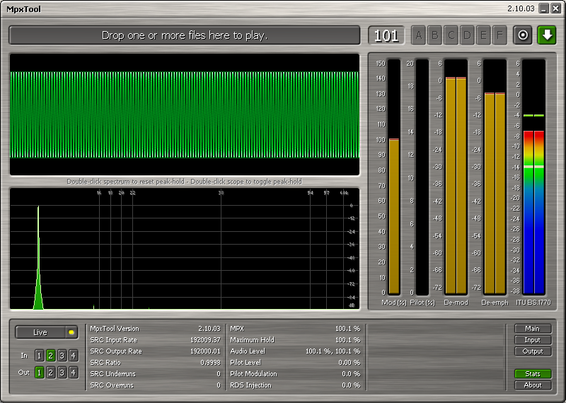

PostPosted: Tue Aug 02, 2011 11:01 am
- In FM calibration: Fixed behavior for 20 Hz and 57 Hz sliders. Others were reported to be incorrect, but I tested them (measured the MPX output) and they work fine...
It's still not working the way it's supposed to be.
Try the following.
Press reset, set FM transmitter on.
No stereo/rds/pre-emphasis.
Set the soundcards correct.
Set 23,28,33,38,43,48,53 kHz in transmitter calibration.
You should not hear this sounds.
But i can hear them and see them on the pira analyzer that they are stereo decoded. Because when i select the 38 kHz test tone there's no peak at all.
But you can try this too with VAC and MPX tool. Set MPX tool to Composite mode.
This tone should be 33 kHz !!

PostPosted: Wed Aug 03, 2011 12:44 am
@eldoradofm: Ah, clear. What happens here is that my tone generation code doesn't check if the samplerate is high enough. The correction itself works fine, it's just the beep tone generation that's wrong here. Will fix it.
