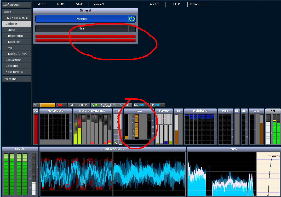

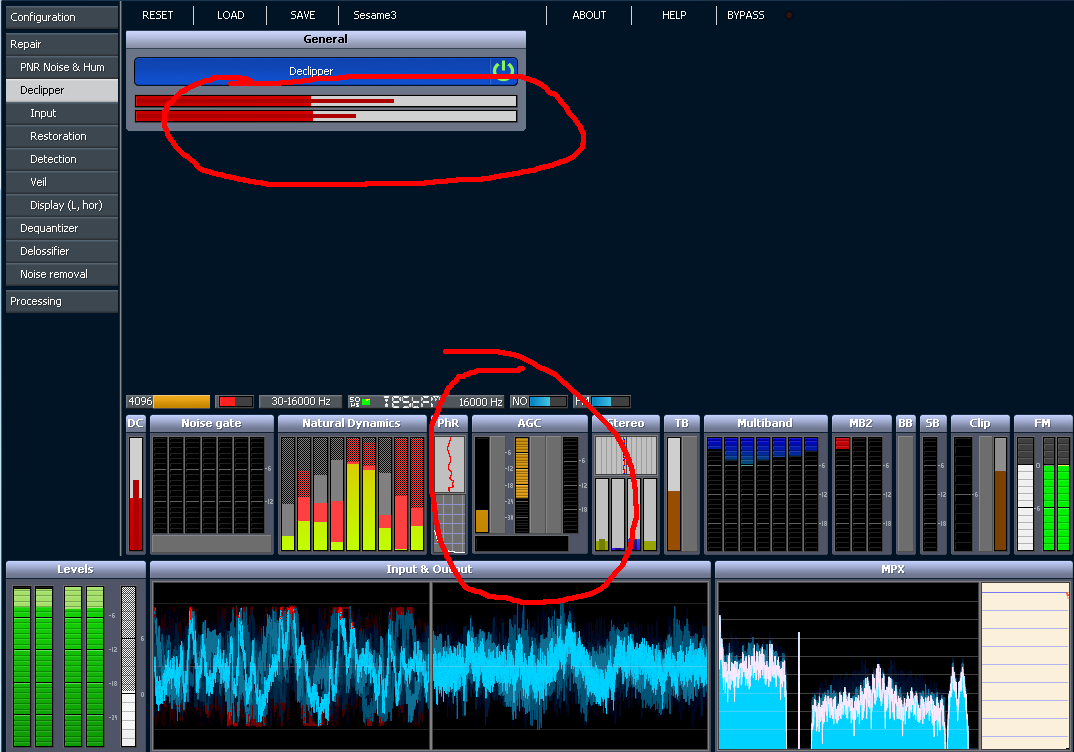

There is a strange level-issue in 8.01 that I experience: input-level into the Declipper is maxed out and seems to be way higher than it should be, and so the level into the AGC is way higher, therefore more reduction.
8.01-BETA14:
In comparison, same preset in 8.00, when everything is as it should be (also slightly less CPU usage):
8.01-BETA14:
I've just compared a preset in 8.00 vs 8.01 BETA014, and they were nearly identical (not completely, probably caused by a difference in Hard Limit). Anyway, nothing like what you're describing. Can you send me your (full!) settings?
Hmm, interesting... I've sent you the sts via PM.

Posts: 4240
You have Input level more then 0 in ST
PostPosted: Wed Jul 27, 2016 6:43 pm
Could be, but that would be the same in 8.00.
PostPosted: Wed Jul 27, 2016 10:54 pm
Posts: 4240
Hmm i just checked (beta13) when i rise input absolutely nothing happens, except light-green bars.
PostPosted: Wed Jul 27, 2016 11:40 pm
Ah. Ok. Radiofreak also found the issue - if you set the input sample rate higher than 48 kHz it boosts the level.
